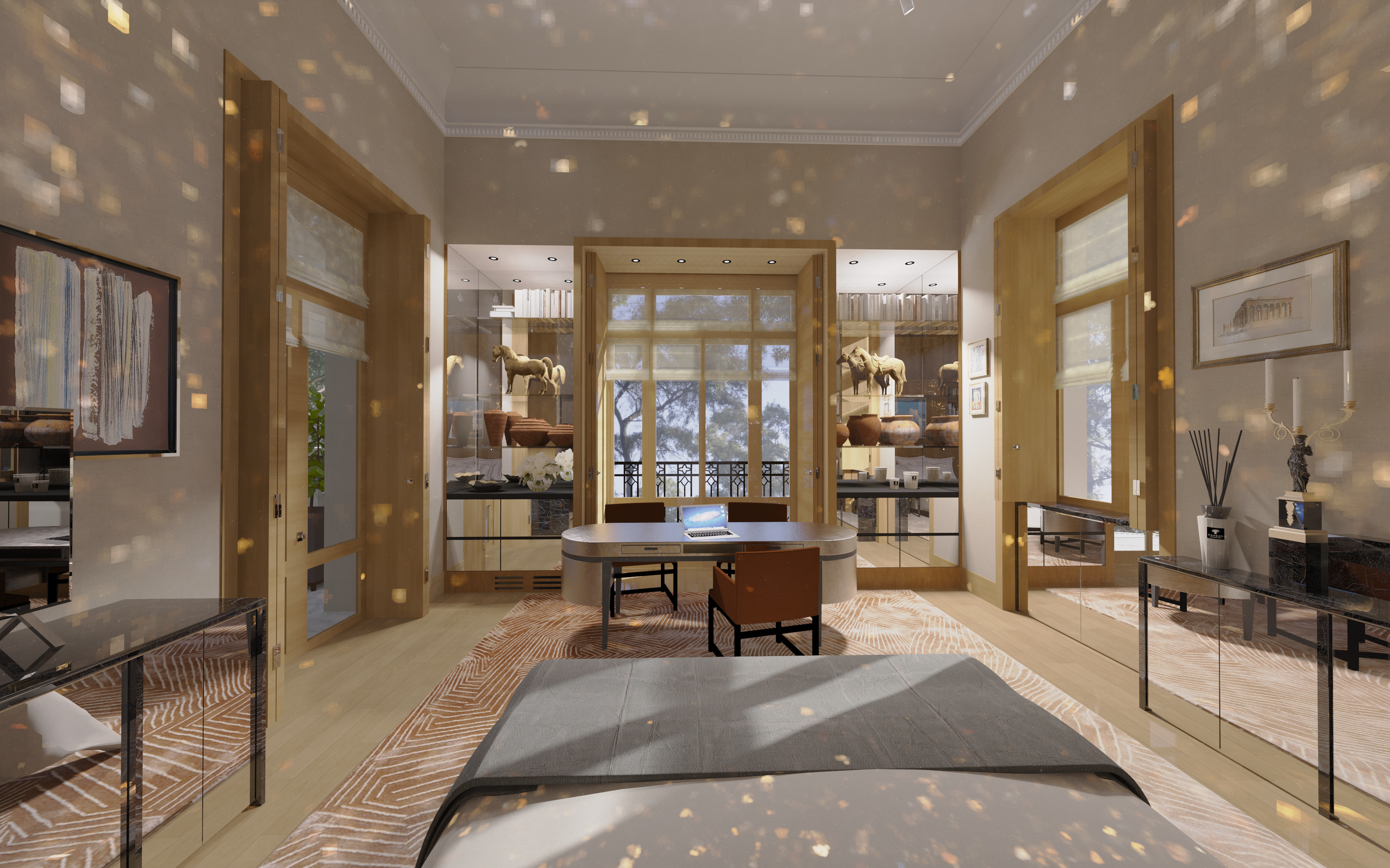

Hello everybody,
I’m new to this community and a little bit too making renderings with Keyshot, I am having trouble trying to set the lights for this interior rendering I’m doing. How can I get rid of these undesirable light spots?
Thank you in advance for your help,
I
Hi Ingrid and welcome!
I think this has to do with ‘caustics’ being enabled in the lighting section. While some people might enable caustics more often I personally won’t use it much inside an interior. Or you have some closeup from some detailed glass objects.
If disabling won’t help we have to find another cause…
